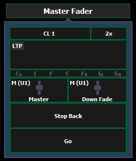

Main Fader Configuration
Use {Main Fader} to open the master fader configuration window.

Buttons & Slider
You can select to use default mapping for the fader, or you can use local mapping.
