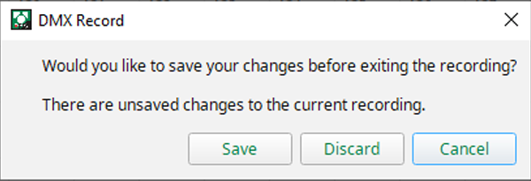

Exit - To exit the recording. If you exit the recording without saving you will be prompted to save.

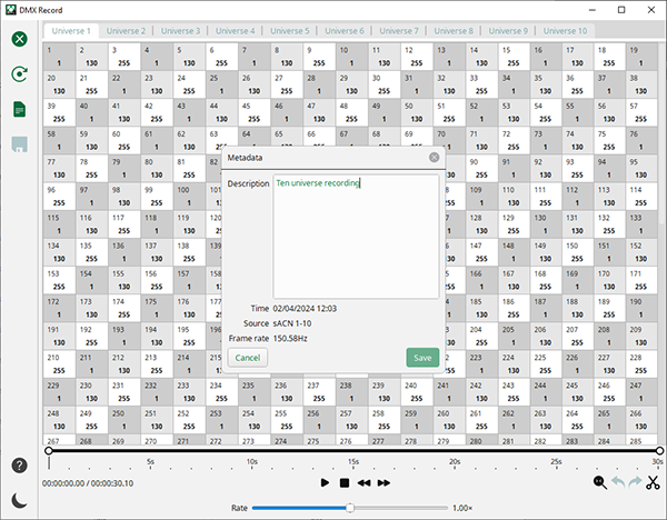

View Metadata - This will allow you to add useful information about your recording. The description could include details about the lighting sequence captured, the number and type of fixtures that have been recorded plus patching information. Adding metadata to your recording can be very useful when it is imported into a Designer 2 project.

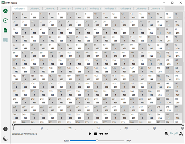

Universe snapshot
This area of the UI has a tab for each universe included in the recording. The universe view has shaded boxes, which show the channel numbers, from 1 to 512, and the channel values, between 0 and 255. This is a static representation of the data that has been captured for each frame.

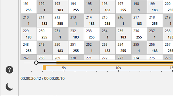

Playback - The overall duration of the recording is indicated here, along with the playhead showing the position of the current frame being viewed. Clicking on the time strip moves the playhead. The zoom/scroll bar allows you to zoom in to view the time strip at finer resolution and grab the bar to scroll. This is particularly useful in tandem with the Trim function to identify the exact start and stop frames required.
Timestamp showing playhead position / recording duration.

Trim - With this tool you can edit the length of the recording, by trimming off any frames not required at the beginning or the end of the capture.

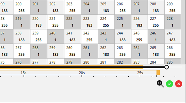

In trim modehandles appear at the beginning and the end of the time strip, and the zoom bar highlights the current recording section in view. As the time handles are dragged, the playhead comes under the cursor to indicate the current frame that is being displayed. Clicking on the time strip moves the playhead and updates the frame in view in the snapshot window. Use the handles on the zoom bar to zoom in and scroll to a section of the recording at finer resolution if it is crucial to trim to a particular frame – for instance when a channel value first changes.
Press to confirm or
to cancel your trim edits to the recording. The duration time will update.
