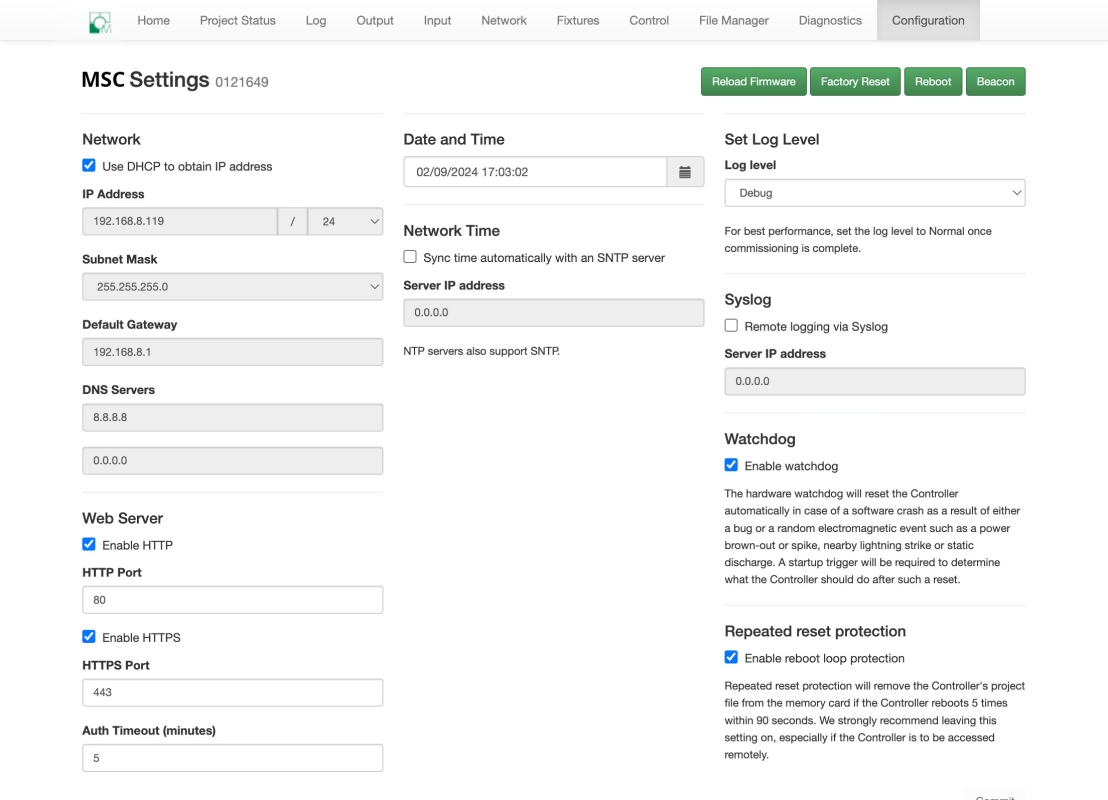

Configuration
Allows you to change any of the controller configuration options as described in Controller configuration.
All the Controller's configuration settings are displayed and can be changed here, see configuration for details.
Remote upload
In addition, at the bottom of the page, is the means to upload a project file remotely via the web interface as an alternative to uploading directly from Designer. See the network section to learn how to generate a file for remote uploading.
IMPORTANT: Controllers must be running the same version of firmware The embedded operating system, stored in internal flash memory or on the memory card. as the Designer software. Uploading a project file to a Controller running different firmware may result in the project failing to load and run. Check the Controller's home page to determine compatibility before attempting a remote upload.
