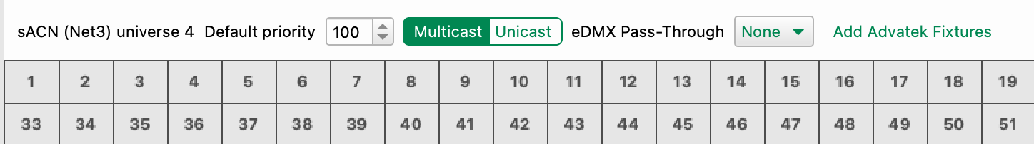

Patch window
This window comprises two main sections, to the left is the Browser, with the rest of the window being a graphical representation of a protocol's ports or universes. The number of address columns displayed per row can be changed using Preferences.
If you are using an MSC X, Atlas or choosing to output eDMX from an MSC or MTPC then you must use the Protocol Properties dialog to configure these protocols, see Controller Protocols.
Patch Columns
Use the Controller column to select the Controller for patching. Add Universes to the project with the Add Universe dialog. Set properties for eDMX protocols with the Protocol Properties dialog and set your Patching Preferences with the Preferences dialog.
Use the other columns to select the required protocol and universe/s to determine which universe/s is/are displayed in the main working area.
NOTE: The patch columns width can be adjusted to display long value on your screen, by clicking and dragging on the dividers

Patching DMX & eDMX fixtures
Simply select one or more fixtures in the Browser and drag them onto the required start address of the graphical representation. Right click on a patched fixture to unpatch it or clear the entire universe/port, drag it to move it (change its address). Fixtures may be patched to multiple addresses and universes/ports. Patched fixtures are shown in blue in the Browser, unpatched black.
To patch a fixture:
  1. Select the relevant Controller, Protocol and Universe/s.
  2. Scroll down to the required Universe.
  3. Select the fixture in the Browser
  4. Drag and drop the fixture onto the desired start address

sACN Output Customisation
When configuring sACN Universes, it is possible to set:
Casting
Each universe can be configured to Multicast (the default) or Unicast (send to a specific IP Address).
When setting to Unicast, multiple IP addresses can be set:
This can be setup more quickly using the Import function. More information can be found here.
