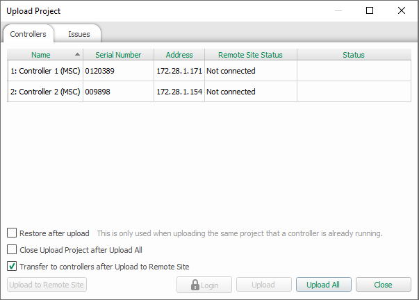

Once you have confirmed that your programming is as you want you can upload to the Controllers by either pressing the Upload button on the Network window or via File > Upload (Ctrl + U):
Direct upload (as opposed to remote, see the web interface), is not possible without connected Controllers (see the network section) but this allows you to upload your programming to one or more Controllers for stand alone operation.
You can either use the "Upload All" button to upload to all connected Controllers or select specific Controllers from list and press "Upload" to target them alone.

Restore After Upload
Check the "Restore after upload" box if you want the Controllers to continue playback of active timelines and scenes from where they left off, useful for soft openings when programming is still being tweaked while the installation is open to the public. This is not the same as a startup event and will only restore active playbacks. Note however that changes to the fixture schedule or patch will force the Controllers to reset playback and so cause a momentary black out.
Close Upload Project After Upload All
Check the "Close Upload Project after Upload All" box to close the Upload dialog once the upload process has completed successfully. This option will persist across all future uploads.

Upload Options
The three upload buttons all serve slightly different purposes. Upload All will upload the project to all the local controllers in a project (which is usually what you want to do), Upload will only upload to the selected local controller (useful in cases where you are only making tweaks to a single controller but don’t want the other controllers to reset), and Upload to Remote Site will upload to all controllers that are currently connected to the Remote Site linked to the loaded Designer Project.
