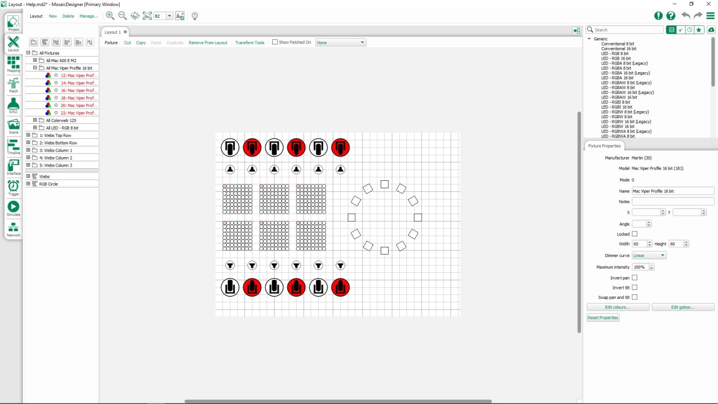

Populating the layout
Simply choose a manufacturer, select the required fixture by clicking on it and then placing the fixture on the layout, it will automatically be added to the Browser and grouped with all other fixtures of that type. Once placed, left click to select it, a red highlight will indicate the current selection, see selecting fixtures. Right click to delete, group or duplicate fixtures.
To add a fixture:
There are several ways to add a fixture to the layout:
- Click on the fixture in the library and then click to place the fixture on the layout (the layout border will turn blue to indicate you are in fixture placement mode)
- Click and drag the fixture onto the layout and release the mouse button to drop it (it will automatically be added to the Browser)
When using Fixture Placement mode, you can pre-set any parameters for the fixture before placing it on the layout.
To add multiple fixtures
You can continue placing fixtures once they are selected (as above) if the Auto Finish option is not checked, this can also be toggled with Ctrl.
Click Finish to exit fixture placing mode.

Fixture Properties
When fixtures are selected from the Layout or the Browser, the fixture configuration section will be populated. If you have multiple fixtures selected, any shared properties will be displayed.
Fixture Identification
With a fixture selected the top two fields detail the fixture's manufacturer (manufacturer id) and model (model id), they are for reference only and can not be edited.
Number and Name
Here you can enter a new name for the fixture, useful to help make the browser easier to navigate, and the means to change the fixture's unique user number.
Every fixture added to the project is assigned a user number which is used as a shorthand method of selecting it, using the web interface's command line for example. Use the up and down arrows to change the number but note that only available numbers are shown so you may need to change the number of another fixture first to make that number available. Note that the user number does not affect the order of the fixtures in the Browser and thus the order used for transitions.
Notes
Below this are two fields for entering any comments about the fixture, useful for annotating the project's documentation. These comments will appear in the fixture report and in exported fixture plans.
RDM IDs
Type in a valid 6-byte UID, then select the add icon, or enter, to add this UID to the list of RDM IDs for the selected fixture. Use the remove icon next to an item on the list to remove that ID from the RDM ID list.
X and Y
Use these fields to set numerically the fixture's position on the layout
It is desirable to position the fixtures on the layout as accurately as possible to improve both the accuracy of the programming (in particular pixel matrices created automatically from the layout) and the general neatness of the project and simulation.
To nudge a fixture on the layout you can use the cursor keys to nudge the fixture selection up, down, left or right by the amount set as the grid spacing. Alternatively, use the up and down arrows by each of the fixture's position fields. Holding Shift while using the cursor keys performs a fine-nudge of 1px.
Angle
Set the angle of the fixture, setting these accurately will allow Pixel Matrices and Simulate to be as accurate as possible.
Locked
Check this box to prevent the fixture(s) being moved using the mouse. Locked fixtures are still included in drag selections and can be moved using arrow keys.
Width and Height
Use these to set the size of the fixture on the layout (1px : 1cm), this is particularly useful when the background image is not to the same scale.

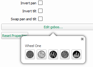

Edit Colours
Fixtures with colour wheels will display an Edit colours... button within the Fixture Properties tab. Clicking it will show the current colours set for the available wheels. Clicking any of the wheels will open the colour picker allowing you to choose the colour matching the colour wheel that is or will be located in that fixture's colour wheel.
Edit Gobos
Fixtures with gobo wheels will display an Edit gobos... button within the Fixture Properties tab. Clicking it will show the current gobos set for the available wheels. Clicking any of the wheels will open the gobo image picker allowing you to choose the gobo image that matches gobo wheel that is or will be located in that fixture's gobo wheel.
Custom gobo images can be added to the following directories:
- Windows: %userprofile%\Documents\ETC\Mosaic\Designer 2\Gobos
- Mac: ~/Documents/Mosaic Utilities/Gobos
Requirements for creating custom gobo images:
- Only .png images are accepted.
- Transparency is preserved.
- Colour is allowed.
- The default images are 128 by 128 pixels, but larger images are accepted. It is recommended to keep them with a square aspect ratio for clear viewing of the image within the gobo wheel selection window.
NOTE: For new gobo images to be detected the software must be restarted.
