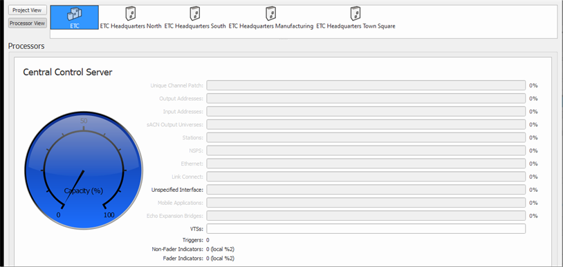

Selecting the [Processor View] button displays a gauge and bar graph with estimated data for the filtered selection, meaning if the Server Project is the selection or if a sub-project is the selection, and it displays data relating to the capacity of the device. The gauge provides an overall estimation of the processor level object and resource limitations. Reference System Requirements and Capacities for a list of the acceptable limitations of a project.
When the key objects and resources are within their own limitations and within the capacity of the processor, the gauge displays in blue. See Gauge and Bar Graph Overview for guidance on understanding the displayed data.
Tip: When the limits of objects and resources for a Server Project or a processor are exceeded, the gauge and the bar graph for that item indicate in red.
With the Server Project selected, the Central Control Server parameters display in the estimator view.
Limits specified below are limits (maximums) for a Central Control Server (Server Project):

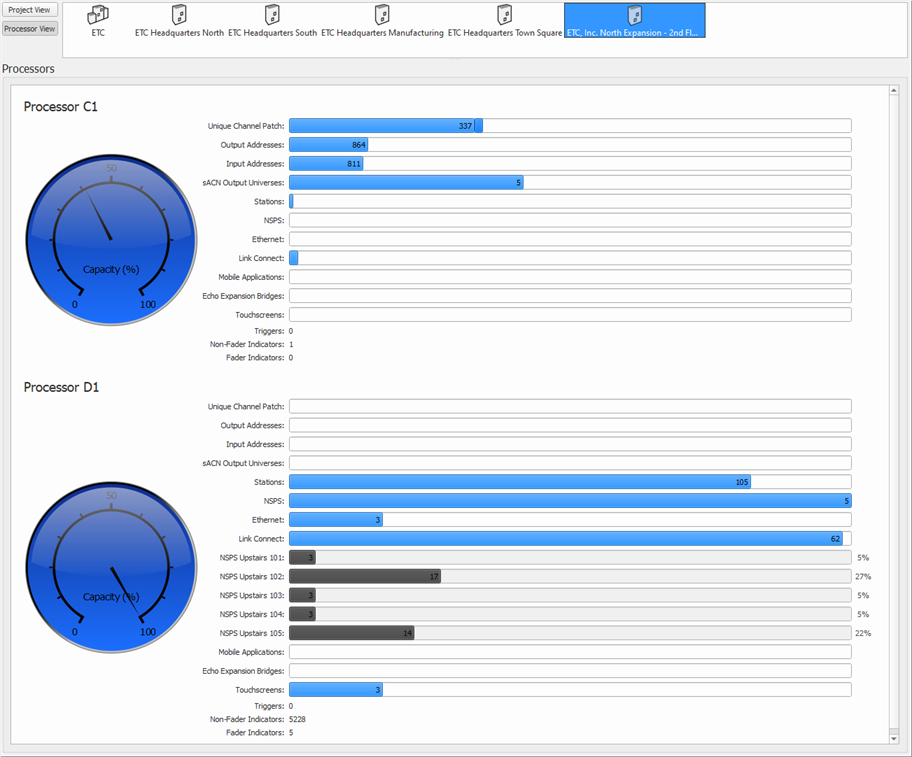

With a sub-project selected, each of the Paradigm processors in the sub-project displays with its parameters in the estimator view.
Limits specified below are limits (maximums) for a sub-project:
