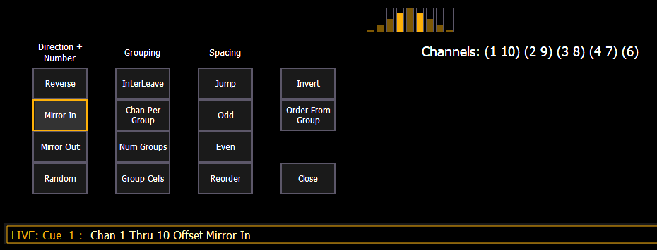

When [Offset] is pressed, a channel distribution display will open.
The following options are available as extensions of [Offset]. Options can be used together. These extensions can be used to create Subgroups. To close the offset display, press {Close}.
Direction
- {Reverse} creates a group with the channels in the reverse order that they were selected in.
- {Mirror In} creates subgroups of channels that mirror inward.
- [1] [Thru] [8] {Mirror In} [Enter] would create 4 subgroups in this order: (1,8) (2,7) (3,6) (4,5)
