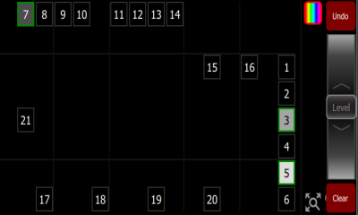

Stage Map (and Shutdown)
The Stage Map button (left-most button below the screen) displays a topographical map of channels fullscreen at maximum size. You may select channels on the topographical stage map for control.
Note: The Stage Map button will toggle between displaying the Stage Map or the previously selected display.
Available Controls
- Pinch two fingers to zoom the display in or out, or use the Zoom button located by Clear. Zoom in to see intensity levels within the channel cells.
- Drag with two fingers to pan the display.
- Single click on a deselected fixture to select it.
- Single click on a selected fixture to deselect it.
- Double click on a fixture to select that fixture alone and de-select all others.
- Use Layout Mode for stage map customization.
- Selected fixtures are indicated surrounded by a green box.
