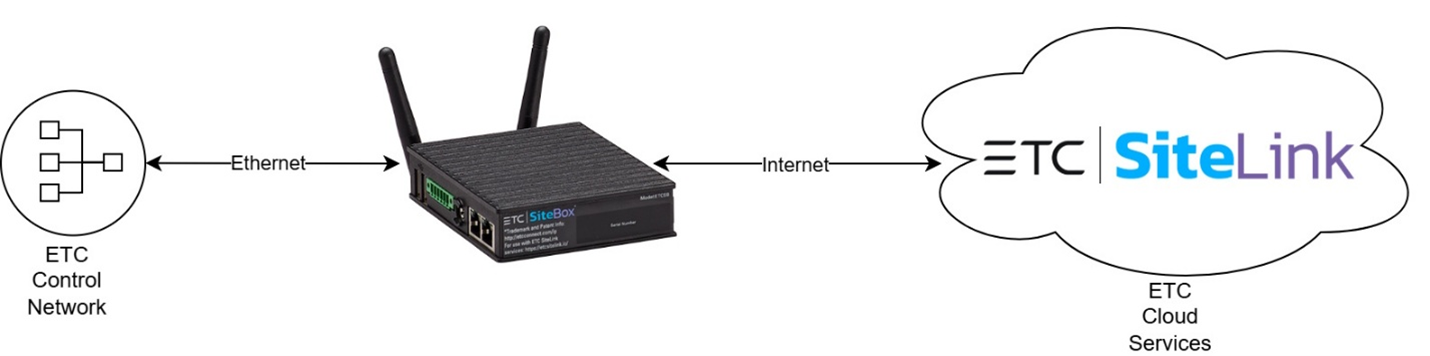

ETC Control System Connection
ETC SiteBox is equipped with a full-duplex wired 10/100BASE-T Wired RJ45 connector for the ETC Control Network (Lighting and/or Rigging). We recommend terminating a network port near the ETC SiteBox using Cat5e/Cat6/Cat6a cable connecting to ETC Control Network.
Firewall and Network Configuration
All connections via the Internet Access network are initiated by ETC SiteBox. This port should be within standard IT best practice security boundaries for a corporate intranet device.
Communications on the ETC Control Network may be initiated by ETC SiteBox or by other control products. In typical usage, this network would not be firewalled or routed between ETC SiteBox and the other control products.
The two networks are not expected to allow intercommunication or routing. Additionally, ETC SiteBox traffic is distinct between the two interfaces; the two networks carry different traffic and are not bridged.
