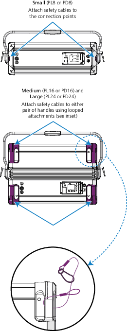

You can mount the fixture using a clamp, junior (28 mm) pin (included), or appropriate mounting hardware on the yoke, or you can set the fixture on the floor or another flat surface. When suspending the fixture, make sure to secure the fixture with appropriate safety cables at the safety cable attachment points on the small (PL8 or PD8) fixture or at the handles using a looped attachment on the medium (PL16 or PD16) and large (PL24 or PD24) fixtures.
Attach safety cables to safety cable connection points on small (PD8/PL8) fixtures; attach safety cables to either pair of handles using looped attachments on medium (PD16/PL16) or large (PD24/PL24) fixtures
