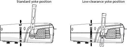

The ColorSource Spot jr ships with a standard yoke for mounting with a clamp. You can adjust the position of the yoke when necessary for low-clearance mounting. Mount the ColorSourceSpot jr in an orientation where the knobs are on the bottom. (This ensures that the accessory slot is oriented correctly, and ensures ease of movement for the Zoom knob and Focus knob.)
ColorSource Spot jr fixture shown in standard yoke position and in low-clearance yoke position
