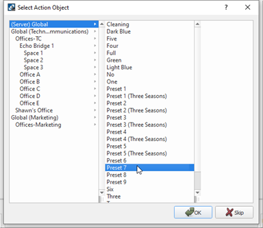

Note: In this example, the macro action is "Preset Activate (LTP)". Filter by space then select the preset that will be activated when the macro is executed (run).

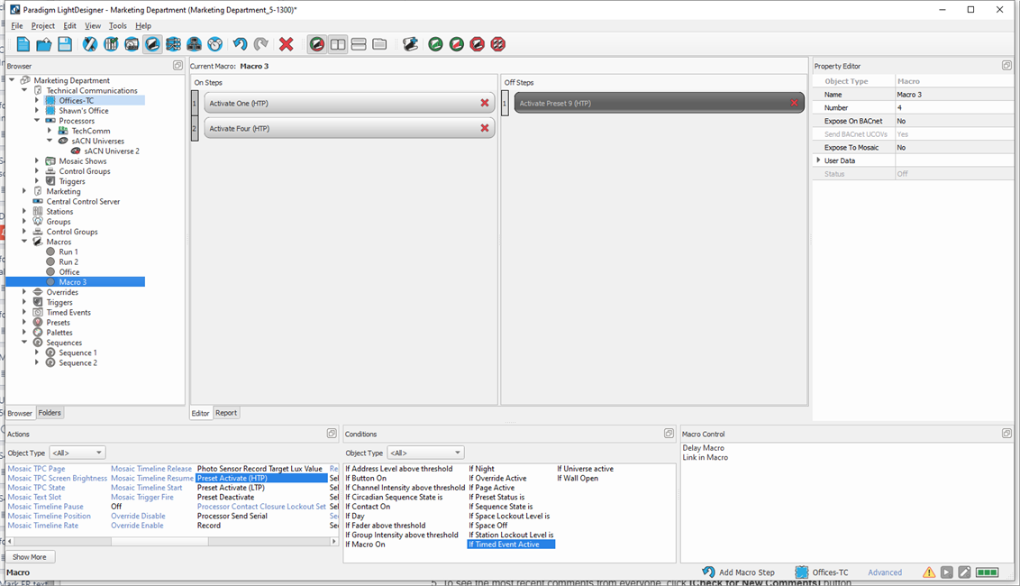

Macros can possess a toggle state and have unique steps assigned to both the "On" and "Off" states. When a toggled macro is executed the first time, the "on" steps will be performed. When the macro is executed a second time, the "off" steps will be performed. You may also assign a button to play specifically the "On" or "Off" steps of a macro.
The advantage of creating a toggle macro instead of creating two separate macros is that any button assigned as a macro toggle can also be configured to reflect the macro state on the station LEDs. This feature allows you to activate the macro "On" steps from one location and the "Off" steps from another.
Tip: When "Allow Toggle On / Off" is enabled, additional views
 (side by side, stacked, or the default tab view) are available to display the On/Off steps in the Macro workspace. See "Macro Editor Toolbars".
