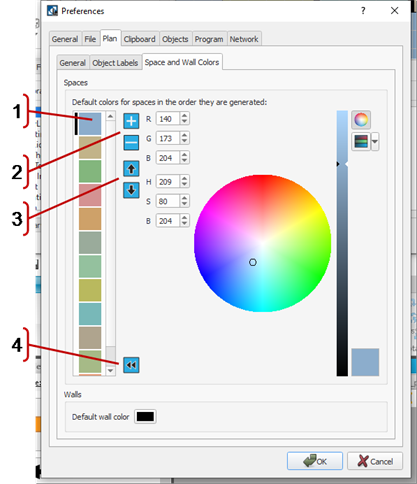

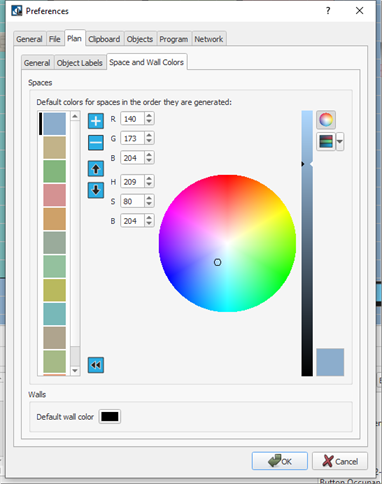

Settings within the "Space and Wall Colors" tab allow a user to specify default colors for spaces in the order they are generated.
The column of colors displayed on the left of the dialog are the list of default colors that will be used for spaces in order they are created. You can change the default colors in the list as well as move the colors up or down the list using the tools provided.
To add a color to the list, select the location where the new color will be in the list and click the [+] Add Color button. Use the RGB, HSB, or color wheel to define the new color.
To remove a color from the list, click to select the color in the list then click the [–] Remove Color button.
Rearrange colors in the list using the Up and Down buttons located in this dialog. Select the color to be moved, then click the [£] Move color up or [¤] Move color down buttons.
Click the [||] Restore Defaults button to restore the list of space colors to the factory defaults.
The default wall color is black. Select the black color chip and choose a different color from the available options in the Select Color dialog.
