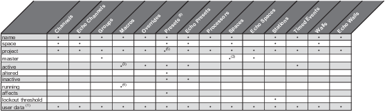

Not all "Folder Conditions" are applicable to all Object Types. The table below identifies which conditions are applicable to each other.
| Channels | Echo Channels | Groups | Macros | Overrides | Presets (6) | Echo Presets | Processors | Spaces | Echo Spaces | Stations | Timed Events | Walls | Echo Walls | |
| name | • | • | • | • | • | • | • | • | • | • | • | • | • | |
| space | • | • | • | • | • | • | • | |||||||
| project | • | • | • | • | • | •(5) | • | • | • | • | • | • | • | • |
| master | • | •(2) | • | |||||||||||
| active | •(3) | • | • | • | • | |||||||||
| altered | • | |||||||||||||
| inactive | • | • | ||||||||||||
| running | •(4) | |||||||||||||
| affects | • | |||||||||||||
| lockout threshold | • | |||||||||||||
| user data (1) | • | • | • | • | • | • | • | • | • | • | • | • | • | • |
Notes: 1) "user data" is a pseudo property that looks for the meta-data tag in the object, including custom user defined tags, as well as the default "User Data x" tags that are automatically generated by LightDesigner. 2) "master" is a raw value where 65536 is full and 0 is off. 3) a macro is active if it is running steps or, for toggle macros, has run the "On" steps but not completed the "Off" steps. 4) a macro will display as "running" when it is currently in its "On" or "Off" steps. 5) Presets will use their space's project's name to test against the filter. 6) Presets include palettes and sequences. Sequences will be expandable to show their steps. |
