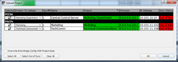

When the LightDesigner project configuration file differs from the configuration on the connected Paradigm processor(s) or Paradigm Central Control Server, the synchronization status will display as "Out of Sync" in the device list. You may upload the current LightDesigner project configuration to a connected Paradigm processor(s) using the [Upload Project] button in the Network view.
Note: Alternatively, from any view within Unison Paradigm LightDesigner, pressing (Ctrl) (A) switches to the Network view and displays the "Upload Project" dialog.
Note: Selecting this check box overwrites the Echo Expansion Bridge configuration data only for bridges that are associated with the selected Paradigm processor(s).
Note: A dialog will display for any errors that require your attention, as well if the LightDesigner configuration has not been saved. Follow the dialog to proceed with or cancel the upload process.
