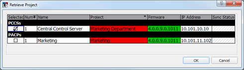

            - Click the [Retrieve Project] button located in the Network view. The "Retrieve Project" dialog displays for processor selection.
            - All connected Paradigm processors and the Central Control Server, when the project is a Server Project,  will display in the list. Click to select the processor or server that you want to retrieve the project configuration file. You can only select one device from the list.
            - Click [OK] to proceed. A "Save Project As" dialog will display requesting confirmation for configuration filename.
