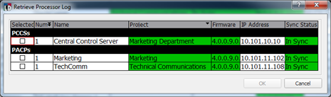

            - Click the [Retrieve Log] button located in the Network view. The "Retrieve Processor Log" dialog displays for selection of the Paradigm processor or Central Control Server.
            - Click to select the Central Control Server or Paradigm processor for log file retrieval from the processors in the list. You may select only one from the list.
