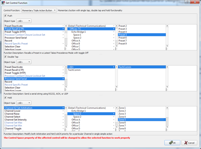

The default action type is derived from the selected control and its default function.
For example, when a Paradigm Inspire Station button or knob control is selected, the default control function is set to "Momentary Triple Action Button", where three actions (Push, Double-tap, and Hold) are available for configuration.

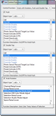

Note: When configuring a knob control (Paradigm Inspire 4-Button with Fader only), the Knob Rotation action allows functional configuration of intensity, hue, saturation, color temperature, Studio Mode Adjust, and tint parameters.

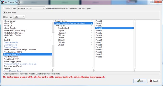

For each default action type (Button Press, Button Action, Button Up, Button Down, Push, Double-tap, Hold, Turn On, Turn Off, etc.) that is defaulted by the control function, select the object type from the first column (e.g. Preset Activate (LTP). The second column of filtering criteria will populate depending on your selections. Continue selecting from the columns of data until the final object has been set.
Note: For control functions that have more than one action (e.g. Momentary Triple Action Button, Maintained Button, Occupancy Sensor with Delay, etc.), be sure to set the control options for all actions.
