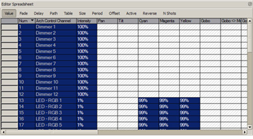

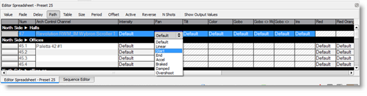

The Editor Spreadsheet is displayed only in the Program/Simulate view. The Editor Spreadsheet is a table view of channels that are in a selection. This selection could be a channel, all channels that are in a selected space, or all channels that are in a selected preset. Use the Editor Spreadsheet is mainly used to edit the stored values within presets, palettes and sequence steps.
Use the Editor Spreadsheet to edit the stored values within presets, palettes and sequence steps. Buttons are provided at the top of the Editor Spreadsheet (Value, Fade, Delay, Path... etc.) when an object is in "Edit Mode" (reference Edit Preset, Edit Palette, Edit Sequence). Use these buttons to filter the spreadsheet data, for easy viewing and editing of the specific parameter values.

Place the preset, palette, or sequence in Edit mode (reference Edit Preset, Edit Palette, Edit Sequence) to access object filtering features, such as "Value", "Fade", etc., in the Editor Spreadsheet.

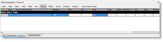

The [Fade]button displays a fade time for the palettes transition.

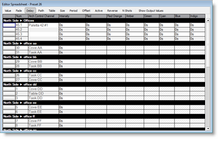

The [Delay] button displays the delay time before transition to preset or palette levels.
The [Path] button displays the cross-fade path used in the preset or palette transition.

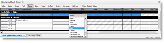

The [Table] button displays effect options that can be applied to the attributes.
The [Size] button displays the relative amplitude (percent) of the selected table or effect.
The [Period] button displays the length of time (in seconds) for the selected table or effect.
The [Offset] button displays an offset (as a percent of 100) from time for the selected table or effect.

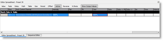

The [Active] button allows you to specify a period (as a percent of 100) from time that the table or effect will be applied.

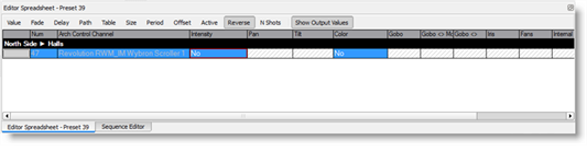

The [Reverse]button allows you to reverse (yes or no as the setting) the table.
