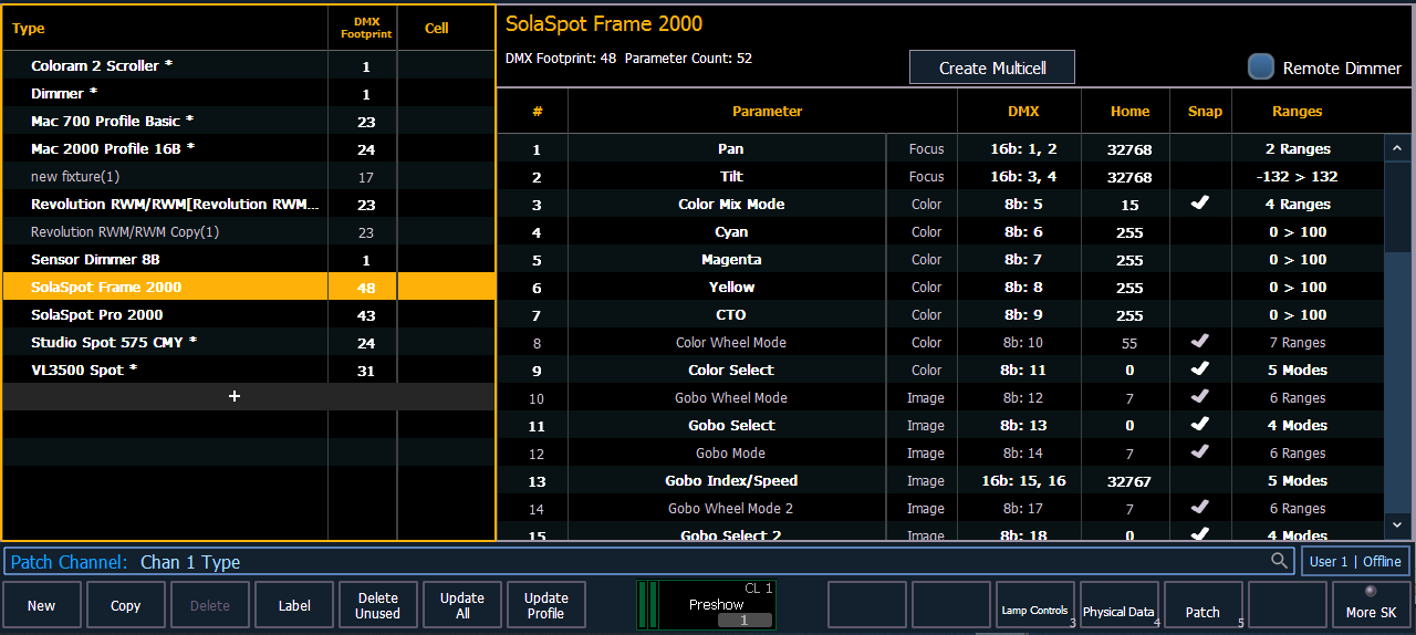

  1. Press [Patch] twice or [Displays]> {Patch} to open the patch display.
  2. Press the {Fixtures} softkey. This will open a list on the left displaying those same fixtures that are currently patched or have been added to the show, and the list on the right are the parameters for the selected fixture. This is the fixture editor.
