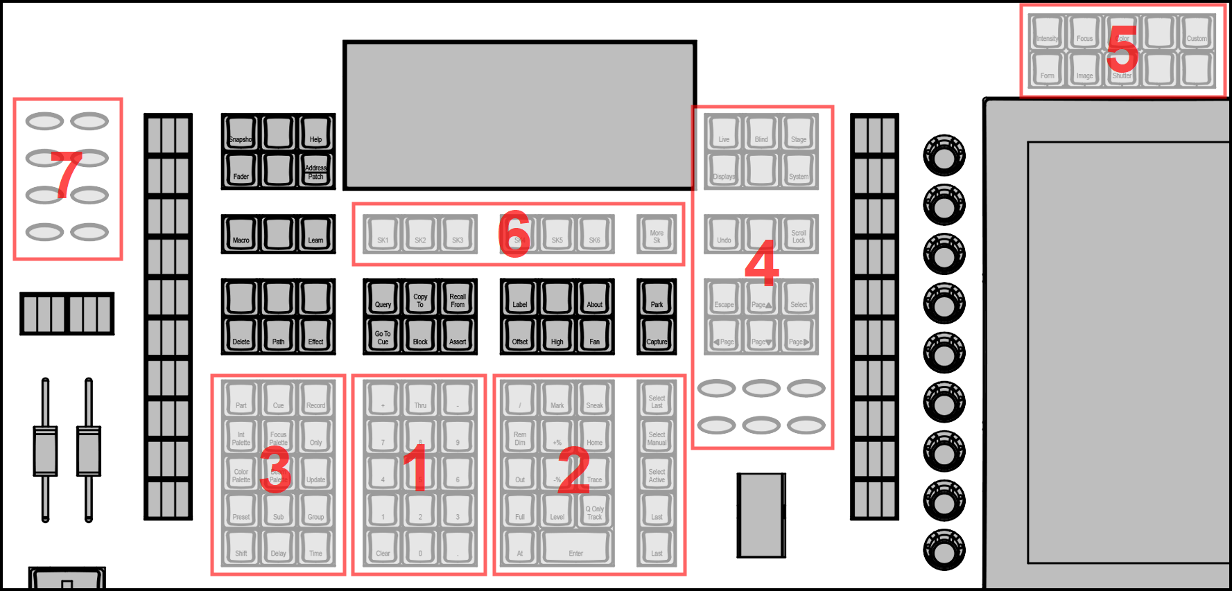

The hardkeys are divided into several sections based on their functionality.
The numeric keypad allows you to type numbers for channel or target selection via the command line, along with modifier keys to alter your selection.
The level controls provide options for altering the intensity levels of channels, along with a number of other non-intensity parameters / targets.
The target controls provide options for altering a variety of record targets, as well as shortcuts to various Blind displays.
The display and navigation keys provide quick access to common displays, formatting, paging, and navigation within displays.
The encoder category keys allow navigation and paging of the main encoders.
Softkeys allow control of context-based software options that change in response to the active display or command line syntax.
The fader control buttons provide additional options for easy local control of fader behavior.
