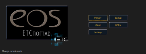

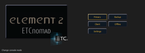

After choosing the Eos family mode, you will then need to select either the Eos or Element console platform.

From Eos to Cobalt
  1. From the Eos Configuration Utility start up screen, select {Settings}. System settings dialog displays.
  2. Select the {Maintenance} button from the options on the right side of the dialog. A complete list of maintenance options will display.
  3. Locate and select the {Switch to Cobalt Client} button from within the maintenance dialog. The Cobalt logo will display in a new dialog and you will be requested to confirm whether you would like to Enable Cobalt Mode.
  4. Click the green check mark in the bottom right hand corner of the dialog to commit to the change or click the red X to cancel the operation. When you have committed to the change, Puck will reboot to the newly selected operating mode.
