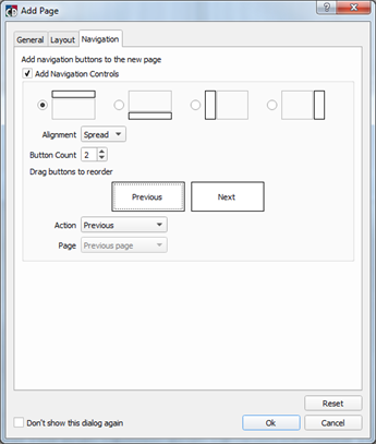

  10. Click on the "Navigation" tab. This display allows you to add navigation buttons (Next, Back, etc.) to the new page you have created. Navigation buttons allow movement between pages of the configuration on the Paradigm Touchscreen or Virtual Touchscreen.
  11. Click the "Add Navigation Controls" check box to enable navigation controls.
  12. Select the radio button of the page location you want to add the navigation controls.
  13. Select the alignment for the controls from the options in the "Alignment" drop down box.
  14. Select the total number of navigation buttons required (limited to 3 total).
  15. Click to select a navigation button and reassign its control using the options in the "Action" and "Page" drop down boxes .
  16. As needed, click to select the navigation buttons then drag them to reorder them, resulting in the order they should appear on the page .
