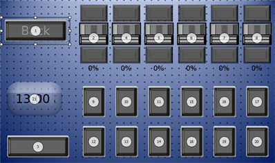

Controls can overlap one another on a page by setting the stacking order for each control. The stack order dictates which control is above or below another in the stack when viewed and during operation. A control with a lower value will overlap a control with a higher value. Another commonly used name for stack order is "Z-order".
Selecting a control and hovering your mouse over the stack tools
in the configuration toolbar will display the stack order for each control on the Page workspace.
A lower number indicates the object is closer to the foreground and a higher number indicates a controls that is closer to the background.
