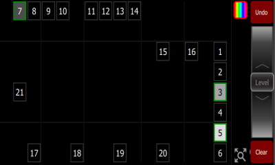

Stage Map (and Shutdown)
The Stage Map button (left-most button below the screen) displays a topographical map of channels fullscreen at maximum size. You may select channels on the topographical stage map for control.
The Stage Map button will toggle between displaying the Stage Map or the previously selected display.
Available Controls
- Pinch two fingers to zoom the display in or out, or use the Zoom button located by Clear. Zoom in to see intensity levels within the channel cells.
- Drag with two fingers to pan the display.
- Single click on a deselected fixture to select it.
- Single click on a selected fixture to deselect it.
- Double click on a fixture to select that fixture alone and de-select all others.
- Use Layout Mode for stage map customization.
- Selected fixtures are indicated surrounded by a green box.
