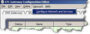

- Select "Configure Network and Services" from the (Network) menu.
- Start the Update (TFTP) Server (Update Service) by selecting the [Start] button next to the "Update Service (TFTP)" section. Once the service begins, service status will update with a green checkmark and the status text "Update Service Running".
