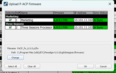

- Navigate to Tools > Upload Firmware and select the firmware to be uploaded. The "Upload Processor Firmware" dialog displays with the available processors for that firmware.
- Select the checkbox of the processors that will receive updated firmware or click the [Select All] button located at the bottom of the dialog. To undo the selection, click the [Clear All] button.
- Click [OK]. A "Confirm Upload Firmware" dialog displays a message for your selection.
- Select or clear the "Automatically upgrade config version after firmware update" checkbox according to your preference and then click [OK]. As the firmware uploads to the selected processors, a progress bar displays on the LightDesigner application and on the related processors for indication of the firmware upload status. When the firmware upload and configuration version upload (if selected) is complete, the Network view will update to display the status, sync status, and updated firmware for the selected processor(s).
