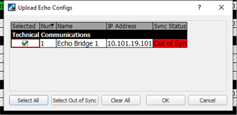

  1. Click the [Upload Echo Config] button located in the Network view. The "Upload Echo Configs" dialog displays for Expansion Bridge selection.
  2. Upload Echo Configuration Dialog
  3. All online Echo Expansion Bridges in the project will display selected for the upload. Select the or clear the checkbox of bridges that will receive the configuration. Additional selection buttons are available for your use including [Select All], [Clear All] and [Select Out of Sync].
  4. Click [OK] to proceed with the configuration upload. As the configuration uploads to the selected bridges, a progress bar displays on the LightDesigner application. When the upload process is complete, the Echo Expansion Bridge(s) that received the project upload will display as "In Sync" in the device list. Return to the Program/Simulate view to review the Expansion Bridge configuration data.
