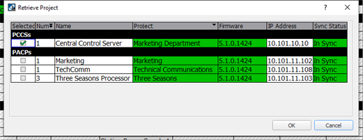

- Click the [Retrieve Project] button located in the Network view. The "Retrieve Project" dialog displays for processor selection.
- All connected Paradigm processors and the Central Control Server (when the project is a Server Project) will display in the list. Select the checkbox of the processor or server that you want to retrieve the project configuration file. You can only select one device from the list.
- Click [OK]. A "Save Project As" dialog displays for specification of the configuration filename.
- Specify the configuration filename and then click [Save] to continue.
