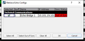

  1. Click the [Retrieve Echo Config] button located in the Network view. The "Retrieve Echo Configs" dialog displays for Expansion Bridge selection.
  2. Retrieve Echo Bridge Configuration
  3. All online Echo Expansion Bridges in the project will display selected for the upload.
    • To exclude an Echo Expansion Bridge from the upload process, deselect the checkbox.
    • Click [Select All] to select all Echo Expansion Bridges in the project.
    • To select only the currently out of sync Expansion Bridges, select [Select Out of Sync].
    • Select [Clear All] to deselect all selected processors in the list.
  4. Click [OK] to proceed with the configuration retrieval. A progress bar will display for each bridge configuration that is retrieved. When the process completes, the selected Echo Expansion Bridge(s) will display as "In Sync" in the device list. Return to the Program/Simulate view to review the Expansion Bridge configuration data.
