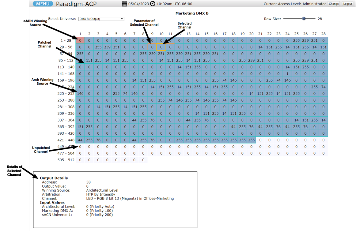

Source Indications
The Universe View provides visual indication of which source is providing the levels of control (winning source). Each source will have a unique color. Selecting an address of a specific color will provide identification of the source in the output details listed below the grid.
Selection and Indications
Selecting a channel in the Universe View displays its details in the details panel located just below the universe grid.
Selected Channel
The Universe View provides visual indication of which channel is currently selected in bright orange, and when the selected channel is part of a multi-parameter fixture those channels (fixture footprint) are outlined in a darker orange.
Example: For example, selecting the intensity channel for a RGB luminaire will displays the intensity channel details in the details panel and highlights the related fixture elements such as the red, green, and blue LED channels in the grid, basically indicating the footprint of the luminaire in the universe grid.
Only one channel can be selected at a time. Selecting a new channel deselects the previous channel. Details of the selected channel displays in the details panel located just below the universe grid.
Input (only) Details Shown
- Address
- Input Value
Output or Input/Output Details Shown
- Address
- Output Value
- Winning Source (where the value is coming from) - options include Architectural Level, DMX, sACN, Holding Last Look, Holding Last Look Forever, and Fading to...
- Arbitration - see Priority and Arbitration
- Channel - a null value means the channel is unpatched, otherwise the channel name, attribute, and space name is shown
