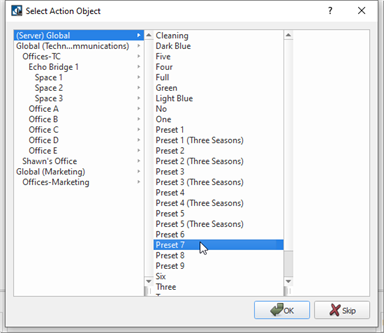

- The Select Action Object dialog is provided to choose the specific object that will be affected by the macro step. The affected space can be filtered which also filters the available objects related to the selected space. Select the space, and then the object from the available list. With the new macro step still selected, you may review and change its properties from the Property Editor.

Note: In this example, the macro action is "Preset Activate (LTP)". Filter by space then select the preset that will be activated when the macro is executed (run).

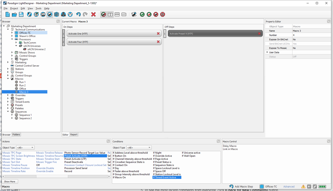

Macro Toggle On/Off
Macros can possess a toggle state and have unique steps assigned to both the "On" and "Off" states. When a toggled macro is executed the first time, the "on" steps will be performed. When the macro is executed a second time, the "off" steps will be performed. You may also assign a button to play specifically the "On" or "Off" steps of a macro.
The advantage of creating a toggle macro instead of creating two separate macros is that any button assigned as a macro toggle can also be configured to reflect the macro state on the station LEDs. This feature allows you to activate the macro "On" steps from one location and the "Off" steps from another.
- To create a toggle behavior for an existing macro, select a macro from the Macros list in the Browser and click the Allow Toggle On/Off button
located in the toolbar. Notice the Macro workspace changes to reflect two tabs showing the "On Steps" and the "Off Steps".
Tip: When "Allow Toggle On / Off" is enabled, additional views
(side by side, stacked, or the default tab view) are available to display the On/Off steps in the Macro workspace. See "Macro Editor Toolbars". - Specify a different set of actions or conditions for both the "On Steps" and the "Off Steps" on their specific tabs. Use the Property Editor to rename the macro and to change any of the macro properties including the display color, priority, space affected, and the actions.
