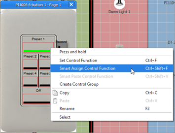

- From the Program/Simulate view, open the station in simulation by double-clicking the station icon in the Plan workspace or the Browser. A graphical representation of the selected station displays in a new floating window (see example of an Inspire 6‑button station below).

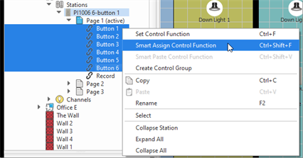

- Select all of the controls on the station by pressing and holding CTRL+ALT and clicking each of the controls on the simulated station, or select the buttons from the page selection in the Browser. A selected control will outline in red in the simulated station.
Note: The selection order of the controls is very important for this feature. Functions are assigned in the order of selection. For this example, if you select Button 1, then Button 5, then Button 2, 3, and 4, then assign the presets starting at Preset 4; Button 1 will be Preset 4, Button 5 will be Preset 5, Button 2 will be Preset 6, etc.
Indicator functions are also incremented in the same way, so if a Preset Activate (LTP) action with an indicator function of Preset Status (LTP) is Smart Assigned or Smart Pasted, the preset will increment for both the action and indicator function.
- Right-click on any control on the station or on the control in the Browser and select "Smart Assign Control Function". The "Set Control Function" dialog displays.
