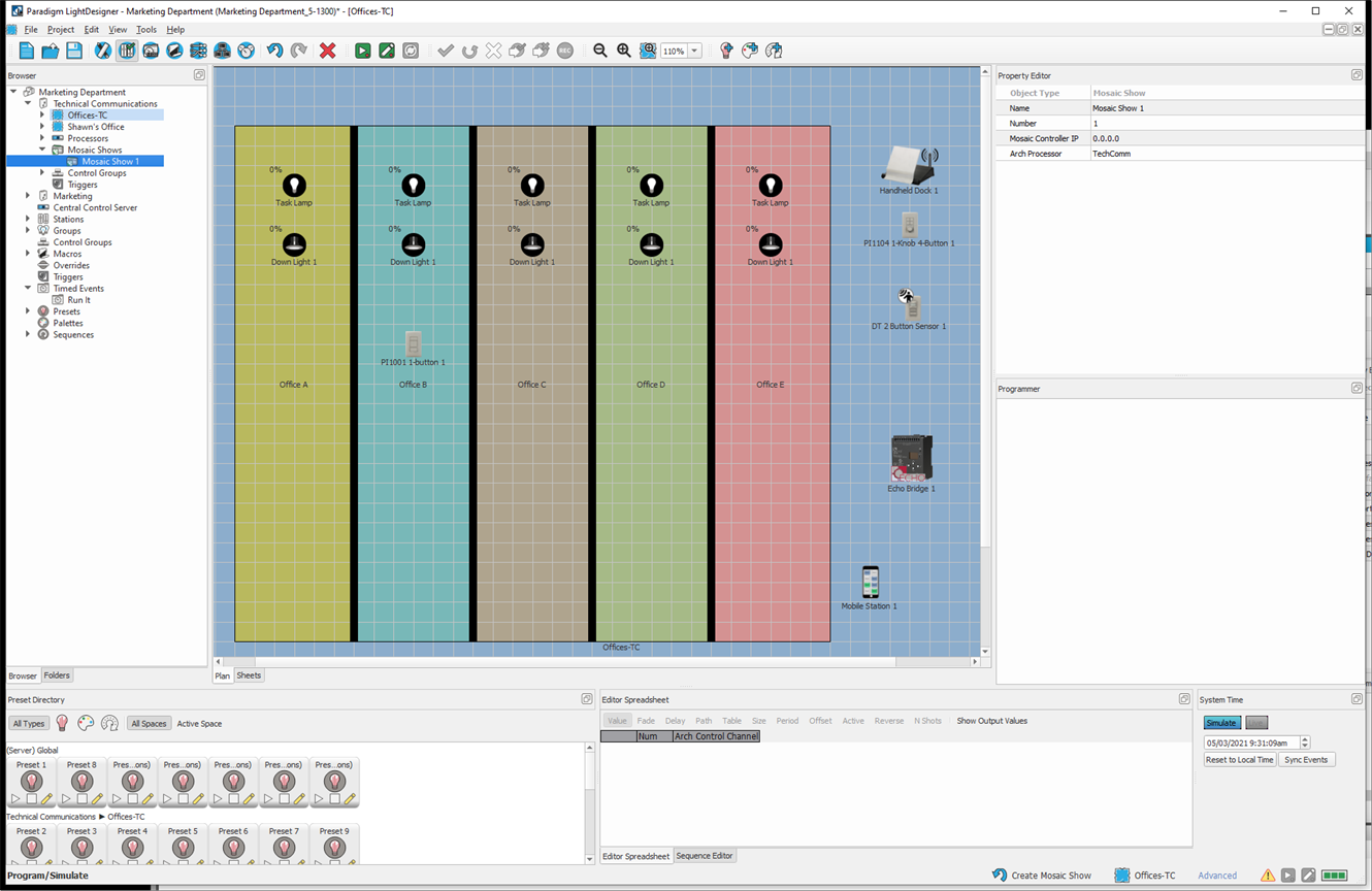

Add Mosaic Show(s) to the LightDesigner Configuration
Each project in LightDesigner offers a Mosaic Shows node directly beneath the Processors node in the Browser. For Server Projects, Mosaic Shows are added to each of the sub-projects, and they cannot be added at the server level.
- Right-click on "Mosaic Shows" node in the Browser and select "Add Mosaic Show" from the context menu. A Mosaic Show is added to the Browser and provided a default name (for example Mosaic Show 1, Mosaic Show 2, etc.). By default the controller is automatically associated to the Paradigm Processor with the lowest processor ID for that project (Processor 1, for example).
- Select the new Mosaic Show in the Browser and use the Property Editor to configure its properties:
- Name - the name of the controller (default Mosaic Show 1). This field is user editable.
- Mosaic Controller IP - the IP address of the Mosaic Show Controller that is the time server of the Mosaic Show you are interacting with. In a system with multiple Mosaic Controllers this will be Controller 1 (by default). The IP address of the Mosaic Controller is configured using Mosaic Designer software.
- Arch Processor - the Arch Processor that the Mosaic Show is associated with. Available processors in the project will appear in a drop-down menu when the property is selected.
Mosaic Trigger Enqueue - Tell a Mosaic controller to enqueue (activate) a configured trigger. Optionally you may direct the controller to only perform the trigger action if its configured conditions are met. Set which Mosaic Show, Trigger number, and enable or disable the Test Conditions. Sending Mosaic variables with trigger activations is not supported in Paradigm.
- Save the LightDesigner configuration file.
