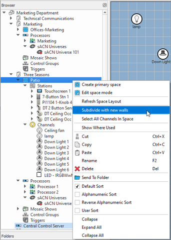

Subdivide with New Walls
Subdivide a space with new walls using "Subdivide with new walls" feature.
A "Wall Layout" dialog displays. You may notice its similarity to the Project Primary Spaces dialog found in the New Project Wizard.
Tip: The subdivide feature is for primary spaces or sub-spaces that are not already combined to another space through a wall. Sub-spaces that are combined to others through walls can not be subdivided.
Select a layout from the dialog and click [OK]. The selected primary space will be redrawn with the new sub-spaces laid out according to the selected option, with new walls that separate each sub-space.

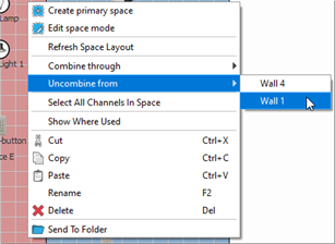

- Right-click in the sub-space and select "Combine through New Wall" from the context menu. The new wall will display graphically in the Plan workspace and in the Browser list for the selected primary space.
- Right-click on the sub-space you want to combine and select"Combine through..." and choose the wall name from the list. The wall will display graphically between the two sub-spaces in the Plan workspace. The Property Editor also lists which "Combined Spaces" the wall affects.

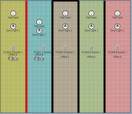

Display Combined Spaces

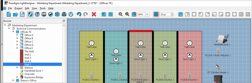

Click to select a e wall in the Browser or Plan workspace. When selected, the sub-spaces that are combined with the wall are displayed with chain links to indicate the two spaces are linked.

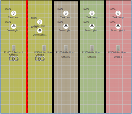

When in the Program/Simulate view, double-click on the wall to toggle its state. When the wall is open, the combined sub-spaces will change to a matching background color, indicating shared control.
