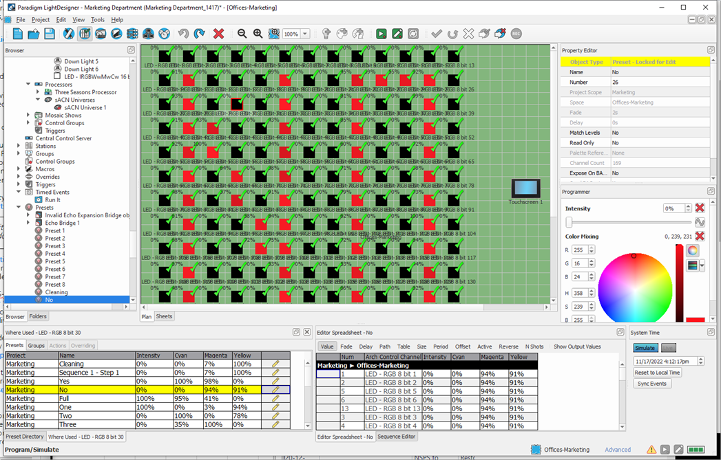

By default, the Where Used content viewer is shown in the lower left corner of the application window and populates with the relevant presets, groups, and actions associated with the selected object. When the viewed object is an override, the Where Used viewer displays all controls, timed events, and triggers that are overridden by the override. When there are no presets, groups, actions, or overrides assigned to the selected channel, that tab will not be selectable or will show "No Results for Selected Object".

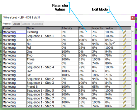

Presets tab
From the Presets tab of the Where Used content viewer, you can quickly review the selected channel's parameter value in each associated preset, palette, and sequence.

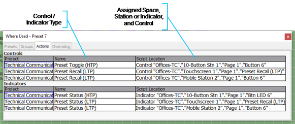

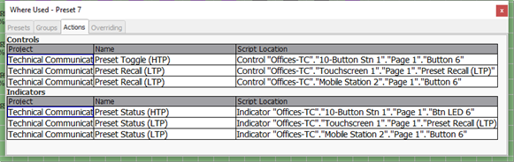

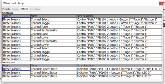

Actions tab
From the Actions tab of the Where Used content viewer, you can view which actions directly affect the selected channel, such as controls (faders and buttons) and indicators.
When a Preset is the selected object, the Where Used content viewer shows the preset action type and the associated controlled space, station, and control or indicator the preset is assigned.
Edit Mode
From the Preset tab of the content viewer, click the Edit Mode button to place the preset, palette, or sequence into Edit Mode. When in Edit Mode, the Editor Spreadsheet or Sequence Editor displays for editing, the Property Editor populates with the related properties, and the Programmer displays for edit.
Click the Edit Mode button from the Where Used content viewer or the Preset Directory again to exit Edit Mode and save your changes.

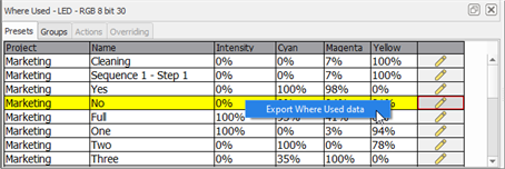

Export Where Used Data
Where Used data can be exported from the Where Used content viewer and saved in OpenDocument Spreadsheet (*.ods) format. Right-click inside the content viewer and select Export Where Used data from the context menu.
LightDesigner exports the data to a single *.ods file with three tabs in the worksheet, Presets, Groups, and Actions.
