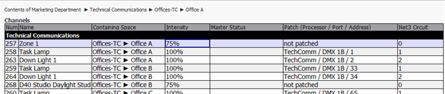

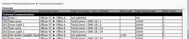

Example: In Design view, the editable data for a Channel is the channel Num, Name, Fixed Load*, Light Source Load*, and Net3 Circuit* are editable. (*Present and editable only when Energy Management is enabled for the Server Project.)
For that same channel in the Program/Simulate view, Intensity is editable.

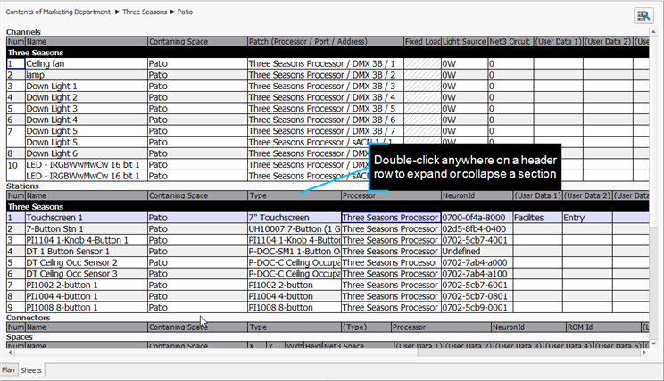

From within the Sheets tab you can expand or collapse data sections by simply double-clicking inside the header row of the section. Alternatively, you can right click on a section header and select either "Collapse" or "Expand" from the context menu.
Example: For example, to collapse the Stations data section, double-click anywhere in the header row.
Repeat to expand the section.

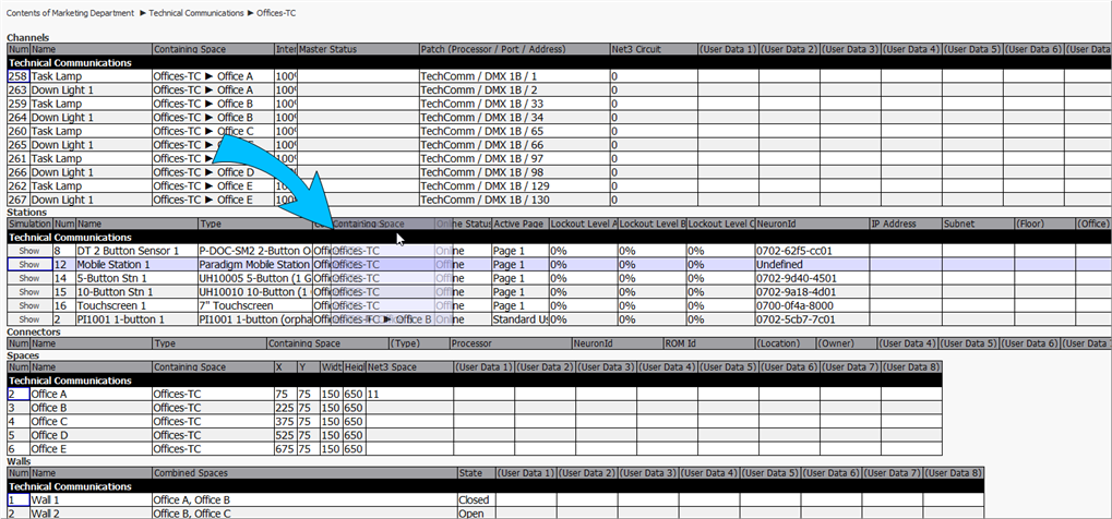

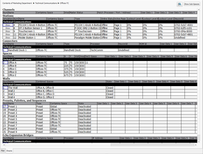

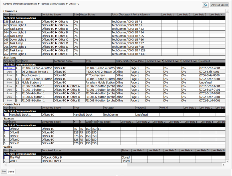

From the Sheets tab you can show or hide sub-spaces from the "Spaces" section of the spreadsheet by toggling the [Show Sub-Spaces] button located on the top right corner of the Sheets page.
This feature is available only with a Primary Space selected.
- with Show Sub-Spaces disabled
- with Show Sub-Spaces enabled

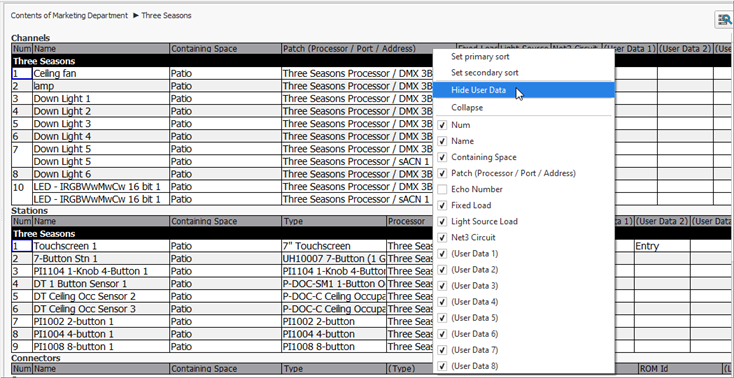

From the sheets tab, in either the Design or Program Simulate views, you can choose to show or hide User Data (object metadata in basic terms) in the spreadsheet. By default, User Data is hidden.
To display User Data, right click on any header row in the Sheets tab and select "Show User Data" from the context menu.
Tip: The columns of User Data may have a different column label than the defaults of (User Data 1), (User Data 2), etc. Users are provided the ability to customize each object type user data tags to assist when creating Smart Folders, organizing the data, etc. All user data fields will display in Sheets and exported views in parentheses (your text here) for visual indication.
User Data fields will display for all object types in the Sheets tab, and will remain enabled even when toggling between the Design or Program/Simulate views. To hide the User Data columns from the Sheets view, right click on any header and select "Hide User Data" from the context menu.

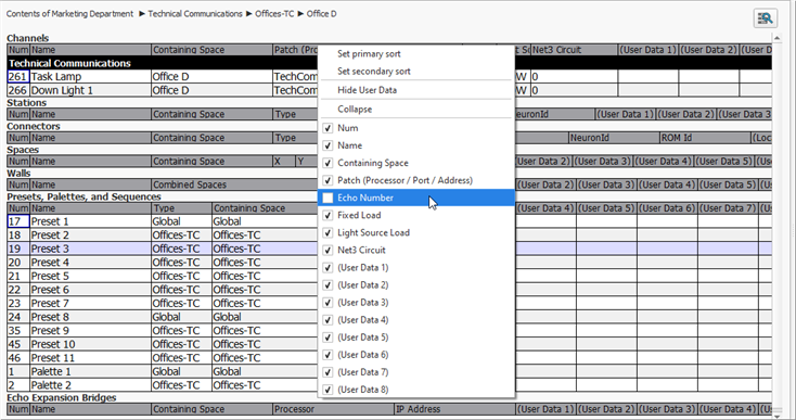

From the Sheets tab you can rearrange the displayed column data by moving them to a new order, changing the column width, and you may show or hide specific columns from the view.
Each data type is separated into sections within the Sheets view. Within each section, column headers that are specific to that data type are displayed. You can rearrange the columns from their default order as desired. Simply click ahd drag the column header into the new location within that section.

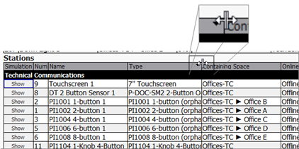

From the Sheets tab, either Design or Program/Simulate view, you can change the column width.
Place the mouse pointer on the line between columns in the column header. The pointer will change to a double headed arrow.
Click with the left mouse button and drag the double headed arrow to the right to widen a column or to the left to make the column narrower.

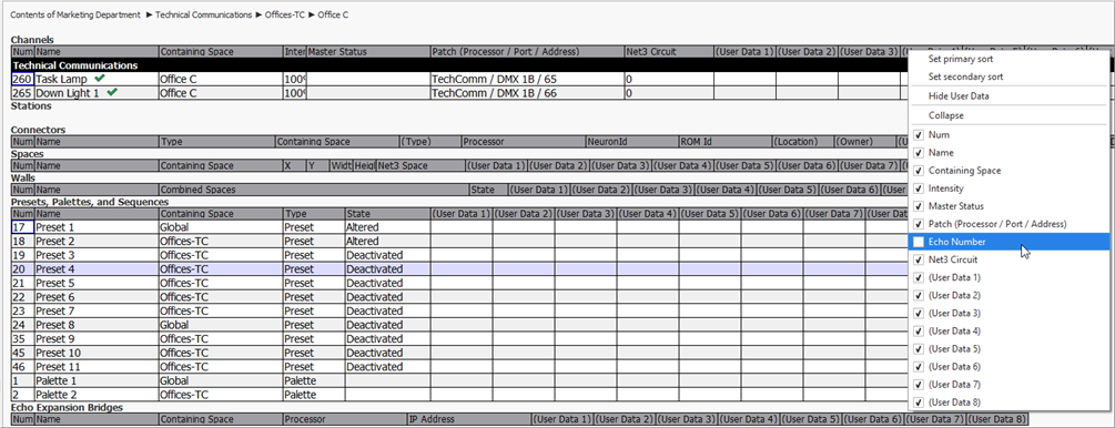

Each data type is separated into sections within the Sheets view. Within each section, column headers that are specific to that data type are displayed. You can show or hide columns of data from the spreadsheet as needed by right clicking inside the header and deselecting the column header name to be hidden from the options shown in the context menu.
The column data show/hide settings persist in the Sheets tab for both the Design and Program/Simulate views.
Tip: The available columns of data for each section may differ depending on the view, Design or Program/Simulate. For example, the Stations section in the Design view will not have a Simulation setting, but the Program/Simulate view will.

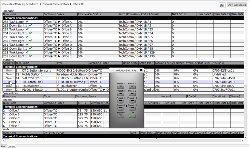

The Sheets tab, similar to the Plan tab, also provides the ability to view a station in simulation while in the Program/Simulate view.
Simply click the [Show] button next to the station in the spreadsheet to display the station in simulation. Click a preset button on the station to activate that preset; all affected channels for that preset will update in the spreadsheet and in real time if you are also in "Live Control".
To hide the simulated station, click [Hide] or click the [X] button on the simulated station image.
