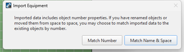

Note: You can merge stations from an imported equipment list with existing stations in the configuration and maintain their control assignments. You can also choose the type of import process applied by selecting either [Match Number] or [Match Name & Space] from the import dialog.

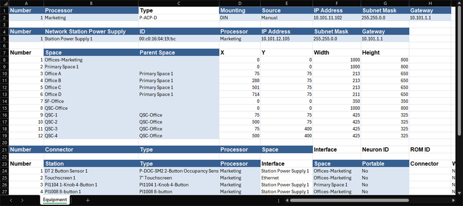

Equipment List Spreadsheet Formatting
At a minimum, the equipment import spreadsheet must include Processor and Space data, although you may include additional equipment and details in the import. The equipment list spreadsheet must be formatted in a very specific way for a successful import. Each import object type has required minimum data for a successful import. An equipment import may be simple or complex depending on which information you are importing.
Tip: The easiest way to create a valid equipment list for importing, is to begin from one that has been exported from LightDesigner. See Export Equipment List, and then edit the data to match your new project needs.

Processor
You must include the Processor Name, Processor Number, Mounting, and IP settings.
Processor Type includes P-ACP-D, P-ACP-E, or P-ACP (Original)
Processor Mounting includes DIN, DRd, or ERn (a DIN mounting type is reserved for the P-ACP-D processor)
Space
You must include the Space Name, and Parent Space Name if the space is within a sub-space. You can additionally create and modify space data through the import process and create project hierarchy through primary space and sub-space.
Network Station Power Supply
You can create and modify Network Station Power Supply data through the import process. The minimum data required for a NSPS import is the NSPS Number, Name, ID, Processor, and IP Settings.
Connector
You can create and modify connector data through the import process. The minimum data required for a Connector import is the Connector Name, Number, Type, Processor that it is assigned to and the Space where it is located.
Station
You can create new and modify existing station data, including touchscreen stations, through the import process and preserve the control assignments for merged stations. The minimum data required for a station import is the Station Name, Type, Processor that it is assigned to, the Space where it is located, and confirmation of whether it is a Portable or Wireless where appropriate.
When importing, you will be prompted to choose whether to import by either [Match Number] or [Match Name & Space]. The selected method processes the imported data differently. Include the station number in the imported content if you are planning to match the import by the station's number.
Select [Match Number] to import stations with the same number as existing stations in the configuration. This process imports new data and addressing information that overwrites existing station data and/or creates a new station when there is no matching station number.

Select [Match Name & Space] to import station data that matches the same name and the same space in the configuration or create a new station and assign the space for it when a matching set does not exist. This process imports new data and addressing information that overwrites existing station data when it exists.
When a station with the same name and space exists, the imported data will overwrite only the changed data specified, and will ignore any unspecified or non-conflicting data.

Importing by Number Data versus Channel and Space Data
When importing an equipment list spreadsheet the Number property must be specified for the object or device. The import wizard in LightDesigner will prompt a dialog requesting whether you prefer to import matching the data by the Number or by the Name and Space.
- Selecting to import by Name and Space brings the data into the project and overwrites any conflicting numbers for objects with the same name and space.
- Selecting to import by Number property does the following:
- Overwrites object names for existing object of the same number and type
- Moves object of the same number and type to the specified space
- Creates objects with default setting in the specified space if no object of the same number and type exists
