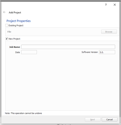

The Project Properties dialog found in the New Server Project Wizard provides the tools to add either an existing project or a new project to the server project.
Add an Existing Project
When adding an existing project to the server project, click the Existing Project checkbox, then click the [Browse] button to locate the project file "*.pcf" to be added. Click [Finish Project] to complete the process. The server project opens, displaying the Plan workspace of the added project.
Add Project to Existing Project in Wizard
Note: When adding an existing project to the server project and the same project already exists as part of the server project, you will be prompted to resolve the inconsistencies of the incoming data against the existing data. You could choose to maintain the resident data in the server project or replace the data with the added project data. This process differs greatly from the Live Edit Synchronization which will replace items based on time stamp or when the edit occurred, keeping only the most recent versions of objects.
Add a New Project
When adding a new project to the server project, click the New Project checkbox, and then supply a job name in the entry space provided. Click [Next] to proceed to the Processor Properties and Data Import dialog.
