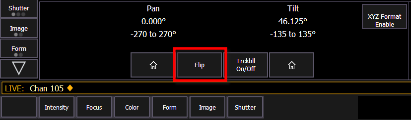

- Aim your fixture at a point on your stage. Press the “Flip” button. Does the fixture return to the same point? If so, pan is mapped correctly. If not, set the fixture's tilt to +90°,or until the fixture is pointing forwards.

- Aim your fixture at a point on your stage. Press the “Flip” button. Does the fixture return to the same point? If so, tilt is mapped correctly. If not, set the fixture's pan and tilt to 0°.
