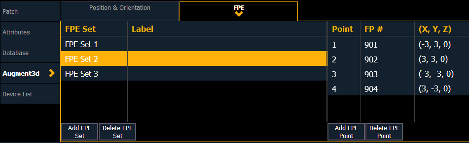

  1. Navigate to the Eos Patch screen. Click the Augment3d tab and select the FPE section.
  2. Enter the measured coordinates of each point. Augment3d will automatically place an FPE Point at each location.

  1. In Patch, enter the Focus Palette number into the "FP#" column that corresponds with the point on which you focused.
  2. Repeat this process until all your FPE points have associated Focus Palettes.

FPE Sets
If multiple sets of FPE calibration data are needed, FPE Points can be arranged in up to ten sets. Each set has its own FPE Points, allowing you to maintain FPE data for multiple spaces within the same Eos showfile. Each FPE set can then be assigned to a channel or range of channels. The fixtures patched to those channels will then use the FPE Points in that set for their calibration and focusing.
Multiple FPE sets can be useful for consoles that control more than one space, or for touring shows working in multiple venues. This can also be useful if all the fixtures in your space cannot focus on the same set of FPE points.
