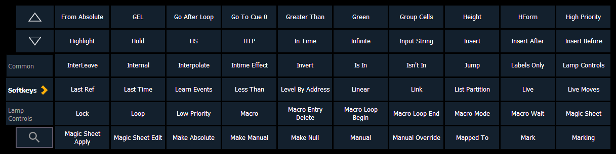

Macro Softkeys
In edit mode, the CIA displays all softkeys available for the system that would otherwise be difficult to find when recording a macro. You can also choose from a list of the most common macro commands, or any lamp commands. The paging buttons allow you to scroll through the available softkeys in any of these selections. Paging buttons are not stored as macro content.
The search button allows you to search a scrollable list of all macro commands. Typing will filter the list. Pressing [Enter] on a command will place it into the macro and return to the search field. [Learn] or {Done} will exit edit mode.
Macro-Specific Softkeys
A new set of macro editor softkeys are displayed while in edit mode including:
  • {Loop Begin} - inserts a start command for a loop with a limited number of iterations. An infinite loop is assigned when you use “0” for the iterations.
  • {Loop End} - inserts a loop end command.
  • {Wait} - inserts a pause for a period of time. This needs to be followed with a whole number of seconds.
  • {Delete} - removes commands from the macro.
  • {Wait for Entr} - inserts a pause in the macro that waits for the [Enter] key. Pressing [Enter]will resume the macro.
  • {Wait for Input} - inserts a pause in the macro to allow you to enter data. The pause lasts until you press the [Macro] key again. Then the remainder of the macro will be completed.
  • {Done} - exits macro edit mode. You may also use the [Learn] key to enter and exit edit mode.
