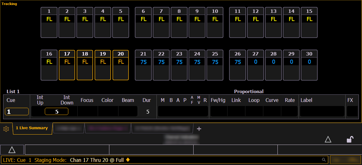

In either Live or Blind, enter staging mode by pressing [Staging Mode] or [Stage]. The command line will append "Staging Mode." Make the desired changes. Staged data will display in orange.
If an Augment3d tab is open, staged data will also preview there. The physical [Stage] key LED will illuminate when in staging mode.
