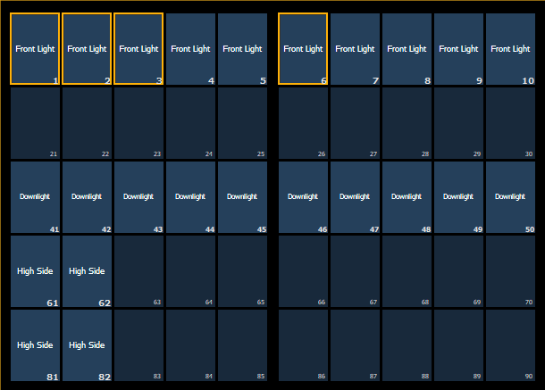

Open a direct select display by selecting {Direct Selects} from the Home Screen and then select the {Channels} button. When channels are posted to the direct selects, you can select one simply by pressing the channel’s button. The command line will show the appropriate channel and the selected direct select will be outlined in yellow.
Channel selection from the direct selects is an additive process. When a channel is selected, it is added to the current selection set. To select only one channel and deselect all others, double-press the channel button. For example, if channels [1] [Thru] [5] are selected from the keypad, pressing {Channel 6} from the direct selects adds channel 6 to the current channel selection. If channels [1] [Thru] [5] are selected from the keypad, pressing {Channel 6} {Channel 6} deselects channels 1 through 5 and selects channel 6.
