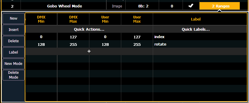

The sixteenth DMX slot for this fixture is gobo function, which has two ranges for index and rotate.
In the fixture editor, you assign a parameter as gobo wheel mode. Click in the range column to open the range editor. Use {+} to add a second range slot. Assign the appropriate range values, and label each range.
Note: For this example, the DMX min and max values were entered and then the Quick Actions Matched function was used so the user values and DMX values match.

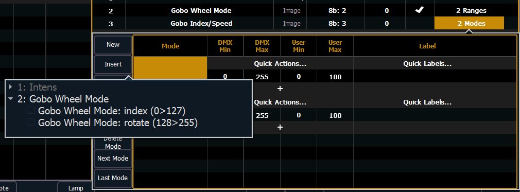

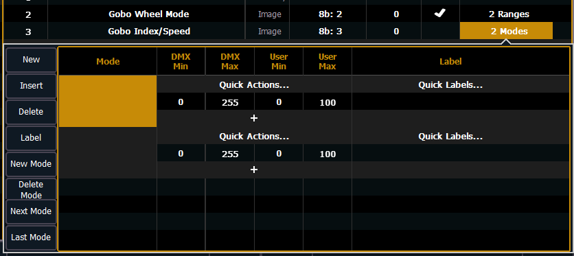

Back in the fixture editor, assign a parameter as gobo index/speed. Click in the range column to open the range editor. Press {New Mode} to create two modes.
Click in the mode cell to open the mode selection window.
This window will display all possible conditions that can be applied to your fixture. In this case, there are only two possible.
If a parameter has multiple ranges and is selected as a condition for a mode parameter, all the ranges for that parameter must be used. The fixture editor will allow you to select a condition for a mode and it will automatically place the other ranges on the next mode.
Assign the DMX and user values. The range values were used for the DMX values. For index, the user values were set to 0-360 degrees. The Quick Labels degree unit was used so the degree symbol will display in the encoder display. For rotate, the user values were to 0-80 rpms.

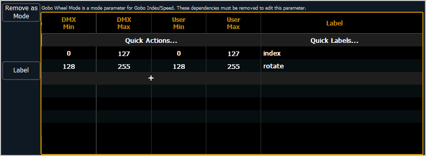

Once the modes are created using the index and rotate ranges, the gobo wheel mode parameter will be read only. The range editor for gobo wheel mode will give an advisory saying which mode the ranges are used in. If changes are needed to those ranges, press {Remove as Mode} in the range editor. After the changes are made, you will need to reassign the modes.
