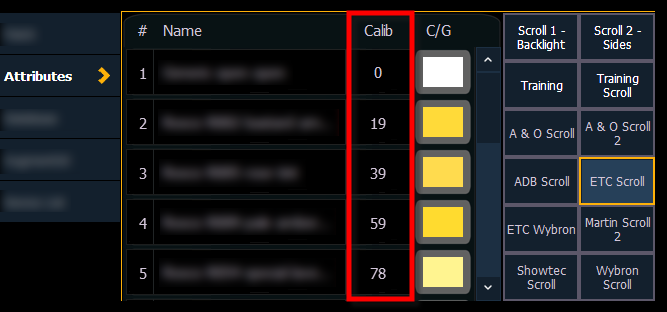

Scroller Calibration Column
Calibration information will be displayed in the scroller calibration column. Values in gray are the default data, and the values in blue are calibrated data.
The displayed calibration information is the DMX level that puts the frame into its center position. Information in the calibration column can be manually edited by clicking on it and typing in a new DMX level.
Note: Calibration data will only be applied to scroller wheels that are assigned to a channel. Data will not be displayed when viewing a wheel with an empty command line.
Note: Calibration data can be returned to its default by clicking on the data and pressing [Clear]. If you are entering in new data and hit [Clear], the data will return to the default and not any previously calibrated data.
Pressing the softkey {Clear Calib} will clear out the calibration data for the whole scroller wheel, returning it to the default data.
