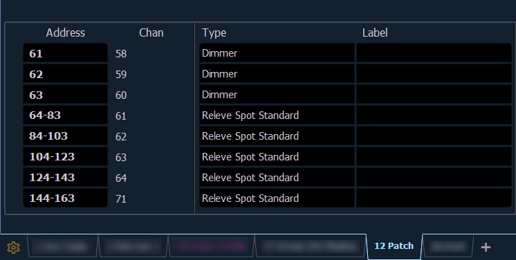

Patching By Address
Pressing [Format] while in the patch display will toggle the mode between patch by channel and patch by address.
[2] [0] [At] [1] [Enter] patches address 20 to channel 1. Pressing [At] will post channel to the command line while patching by address.
Additional examples of patch by address:
  • [5] [At] [1][0][0] [Enter] - patches address 5 to channel 100.
  • [2][0][3] [At] [1][2] [Enter] - patches address 203 to channel 12.
If you try to patch an address that is already in use, Eos will post an advisory to indicate this, preventing you from duplicating addresses in your patch. Eos will also prevent you from patching a fixture that spans multiple universes.
