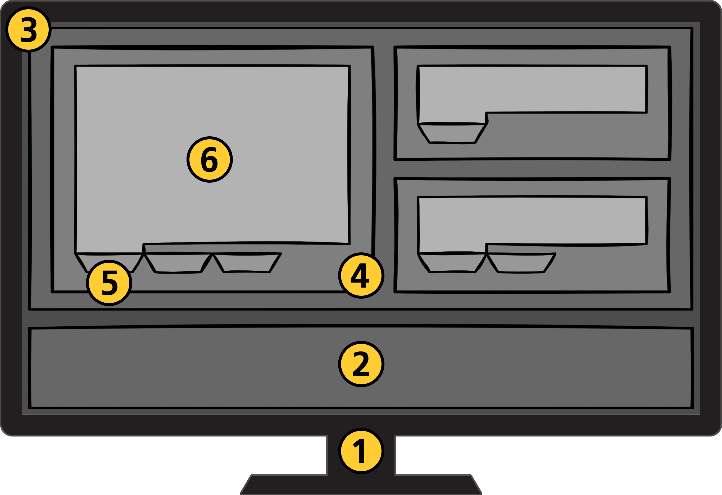

| 1 | Monitor | 4 | Frame |
| 2 | Central Information Area (CIA) | 5 | Tabs |
| 3 | Workspace | 6 | Display |
Monitor
One or more physical displays or touchscreen devices may be connected to your console. The monitor number will display in the upper left corner of the screen. Every monitor can have up to three workspaces.
Workspace

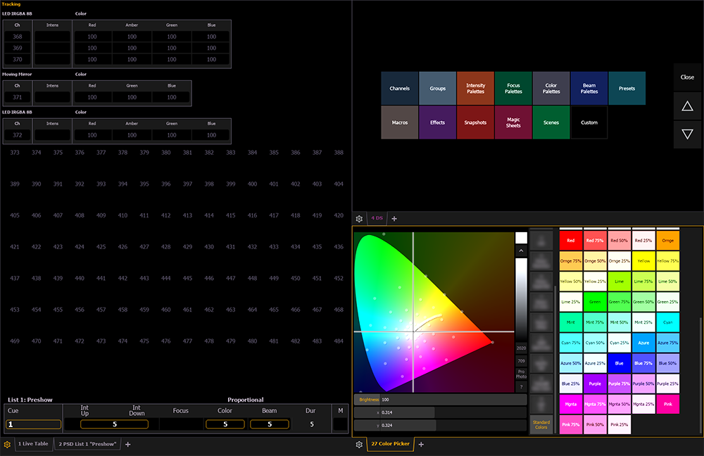

Workspaces offer independent display control on all of your connected monitors. Each workspace can be individually configured with any of the layout, display, and control options available in the Workspace Layout Menu.
Three workspaces are available, identified by the numbered workspace icons in the upper left corner of any monitor. Select an icon to open that workspace, or use [Tab] & [Page Up] and [Tab] & [Page Down] to cycle through workspaces on all monitors. A {Workspace} softkey is available by pressing [Displays]. Hold {Workspace} and type the number of a workspace to open. Workspaces can also be accessed via a connected keyboard with either of the bracket buttons and the number of the workspace. For example, to access workspace 2, use [+2 or ]+2.
Frame
A frame is a subdivision of a workspace. Each workspace can have up to 16 frames in its layout. Each frame can contain multiple tabs.
The number and arrangement of frames can be edited by selecting one of the frame layout buttons
The current frame layout and selected frame are indicated on the right. Once a layout is assigned, you can open Tabs within each frame.
