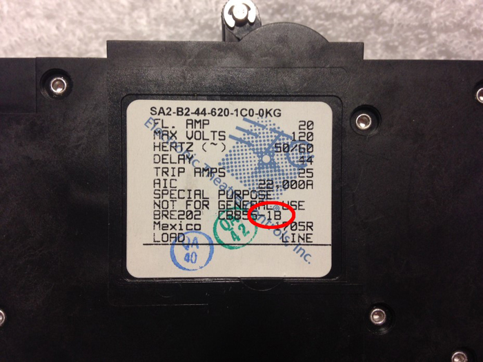

    This has been resolved by redesigning the smartbreaker. Breakers marked as Rev B do not have this issue. The Rev A breakers can be differentiated from Rev B as shown below. The breaker will need to be removed from the panel in order to check this label. Please follow proper Electrical safety practices and have this done by a certified individual. If you have Rev A breakers, please contact ETC Technical Services and we will replace them with Rev B breakers free of charge.
    Rev. B Breaker Sensor IQ
